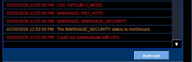

Hi everyone, I'd like to ask for help if anyone else has experienced this.

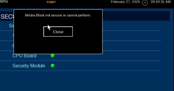

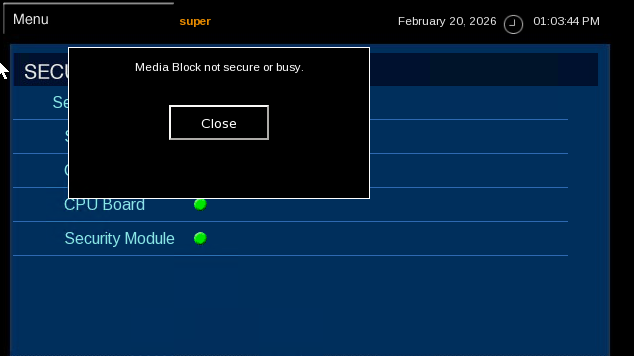

I was projecting normally and suddenly MediaBlock security was triggered. The problem is that now it won't connect because the status is "unsecured" or "busy."
I've already tried updating SMS and MediaBlock, but nothing works.
Images attached  Thx

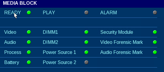

It seem security batteries are oK (and theres power connected). Security module shows no error.
UPC communication present? Is not important for security, but indicates a communication problem.
Safety switches are ok?
Restart, still with error, and marriage not possible?  Does communication with projector work?
