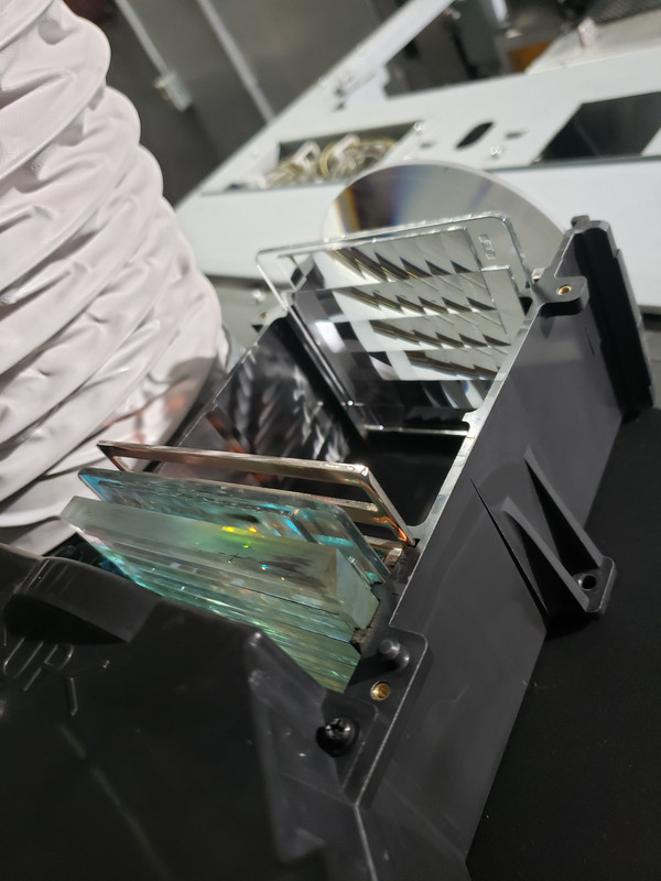

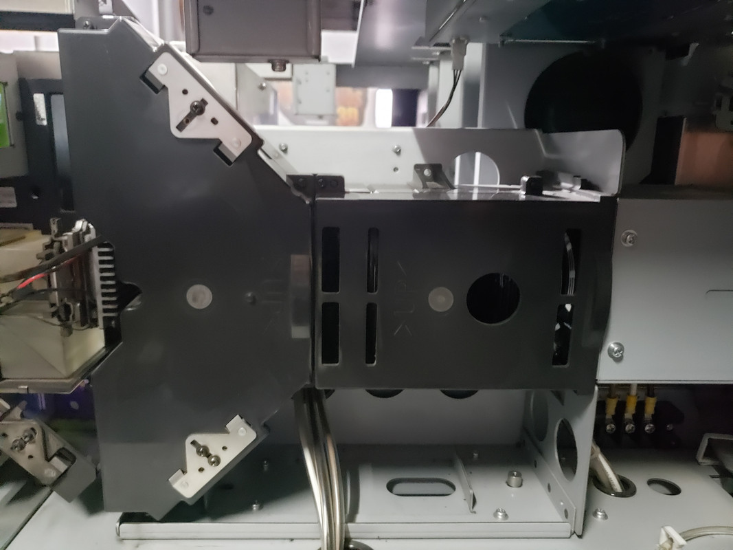

I can't believe that by cleanig the mirrors in that optical Block. This ist only for uniform illumination an polarisation, the next step ist for separate the colours. The t-core is for the picture. It's not possiblle to rotate the pictue mechanically at the white light side. Therefor you have to rotate the t-core, not working.
