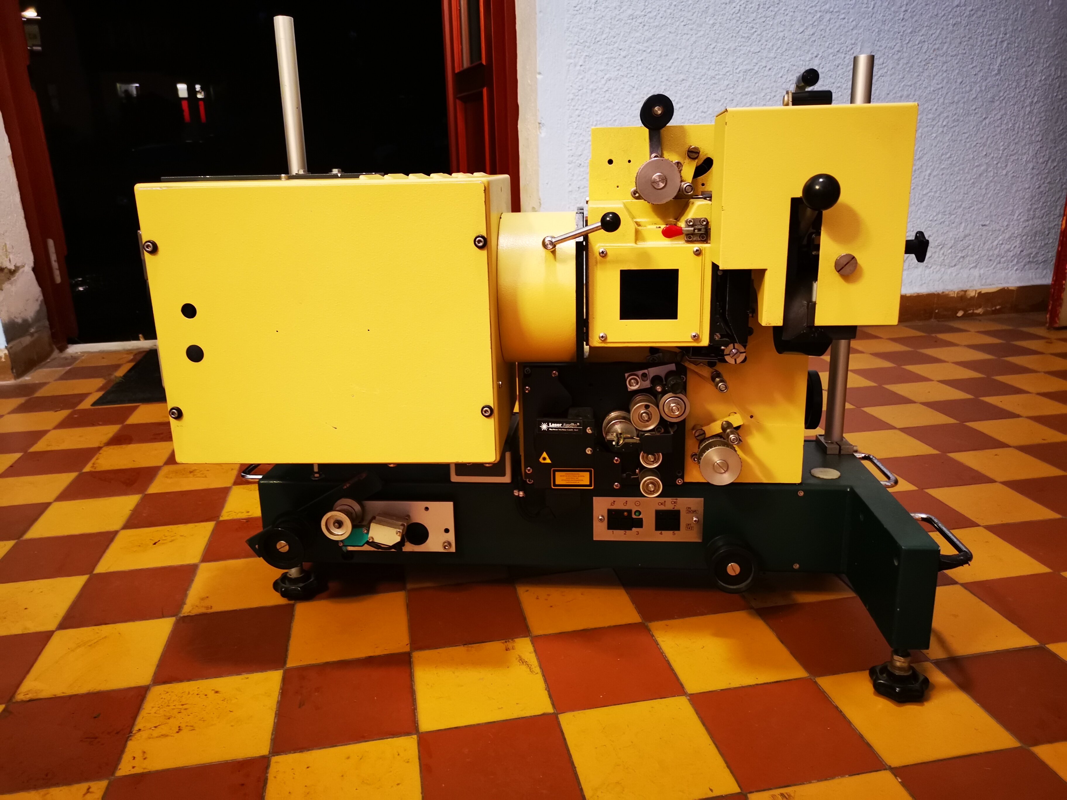

Recently a friend of mine brought this unit, to fix it. It was possible to carry by 2 persons. The lamp compact, 1600 Watts. I do not like it, but maybe this is an option. The spools are horiyontally placed over the machine, on a special attachment.. He did have a couple of those, like 4 or so,  so they can't be rare. But again, the Veronese can be handled by single man, this requires at least 2 people

...und den Preis für die hässlichste Konstruktion aus 118 Jahren Normalfilmprojektionsgerätebau hat es auch gewonnen! 😀
