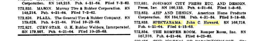

Here's U.S. patent 3.323.429 describing what seems to be the Spectarama lens.

You could, the patent expired long ago.  I was thinking of making an adapter for the lenses, which he also left to us. :)
