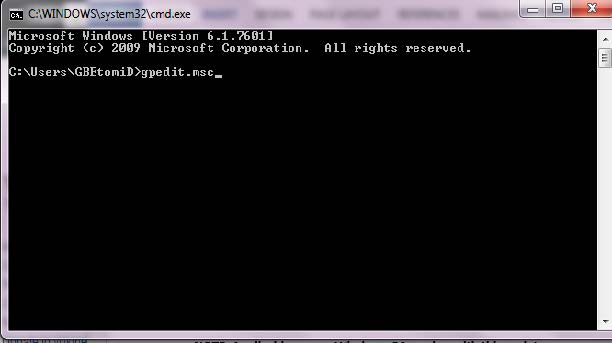

Open Command Prompt, then enter gpedit.msc. The Group Policy Object Editor appears as shown below.
(Anlage CB094_SRX-R320 SRX-R220P SMSC Windows Update.pdf - Adobe Acrobat Pro.jpg)

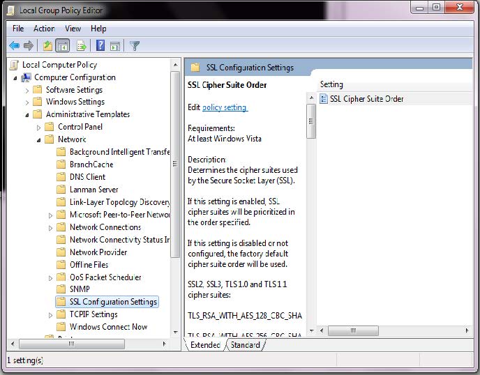

Click Computer Configuration->Administrative Templates->Network->SSL Configuration Settings.
(Anlage DCB094_SRX-R320 SRX-R220P SMSC Windows Update2.jpg)

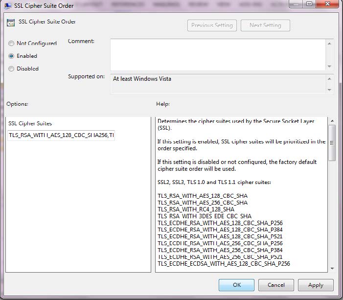

Under SSL Configuration Settings, under Setting click the SSL Cipher Suite Order.
In the SSL Cipher Suite Order pane, scroll to the bottom of the pane.
Select "Enabled"
In ‘SSL Cipher Suites’ delete the following: TLS_DHE_RSA_WITH_AES_256_CBC_SHA,TLS_DHE_RSA_WITH_AES_128_CBC_SHA,
(Anlage DCB094_SRX-R320 SRX-R220P SMSC Windows Update3.jpg)
Click OK
After this procedure it is necessary to restart the computer after modifying this setting for the changes to take effect.
