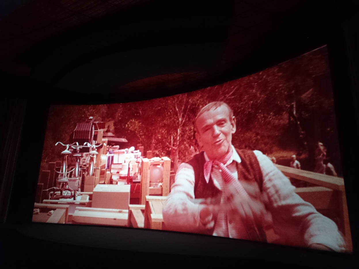

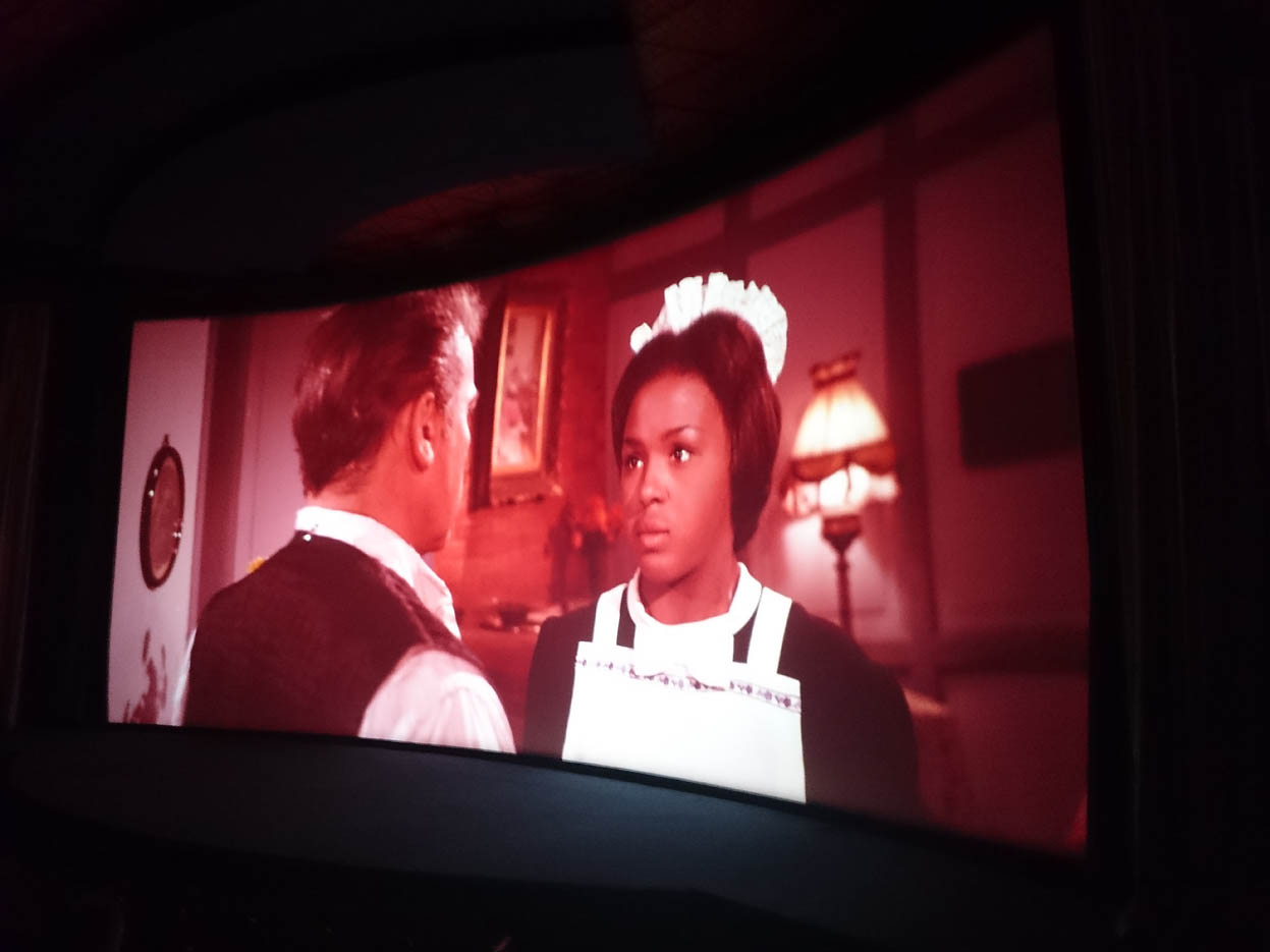

Es war wieder sehr sehr schön!  Probleme im Lichtweg gab es, evtl. auch mit der Filmebene und der Ton immer noch problematisch. Die Ausleuchtung fand ich annehmbar. Filmauswahl, Kopienzustand (zu meist) und das Drumherum waren wieder außergewöhnlich. DANKE!

I want to explain some things what preceded 70mm Weekend 2017 in Varnsdorf. Mainly in matter of optics. On all previous screening we use old ISCO T-Kiptagon´s. Yes, it is old lenses, but at any time best pair what we have. We've always declared that we want to use better lenses. We need very specific focus-length (something between 65 to 68mm). For year 2017 we got borrowed significantly better optic. And it was been visible. We must agree with "cinerama" regarding light distribution. With these new lenses, light distribution was been _significantly_ better than anytime before. Practically same light on whole screen, also in corners. Also enlightenment in auditorium from white screen was been higher than before. I see the difference. Aperture of new lenses is significantly better than before. But this is not only due to new lenses. Also some other new things are in lighth path. For example, we solved problem for what ISCO lenses were totally unusable last year. On whole 70mm Weekend we use current on xenon lamp about 30A lower than before and despite this, brightnes of "The Agony and The Ecstasy" was been high - current was been on minimum for 6kW xenon lamp. We did not want to risk spontaneous extinction or damage.
Back to the optics. We got them only few days before 70mm Wee
kend and unfortunately it was not been lot of time for long testing. And so on, some other problems excited. Mainly DTS players, problem with curtains (10 years without problem...), print preparations, and many, many other things. You surely know that preparation of so complicated event is very exhaustive.
During 70mm Weekend we got borrowed some other lenses and we tested them on monday. We were all shocked what details we seen on screen. We now know that we still have a lot of work to do until next anniversary. You have something to look forward to. Really. It is sad that we did not have it before 70mm Weekend.
